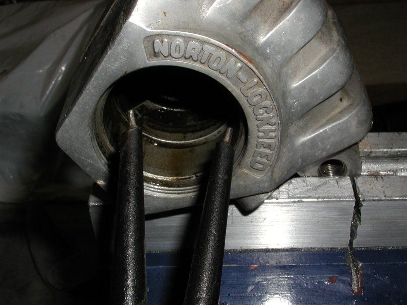

The inside piston can be rather difficult to remove. I first try to twist it out using a large set of circlip pliers pressed against the inside of the piston. This almost always works with stainless pistons and about 25% of the time with steel pistons.
If the piston will not cooperate, I heat the caliper body around the piston and try again. In rare cases this still will not work. I then reheat the caliper body, and using compressed air, blow air through the bleed hole and holding a finger over the hole in the outer piston bore, blow the piston out.
