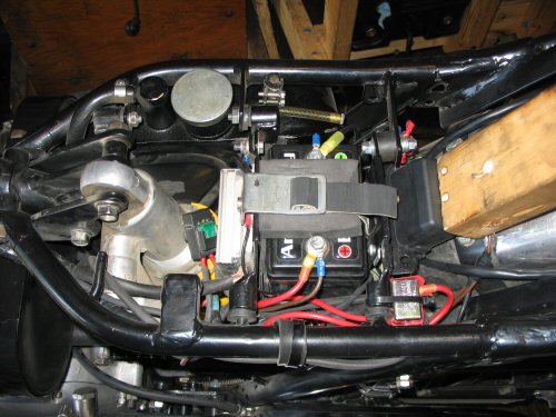

![]() Rectifier/Regulator Honda GL1200 1984 - 31600-MG9-010 Antigravity Batteries AG1201 |

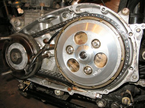

![]() Lucas Powerbase High-Output 3-Phase Alternator 180 watts SRM 3 spring models Pressure plate kit |

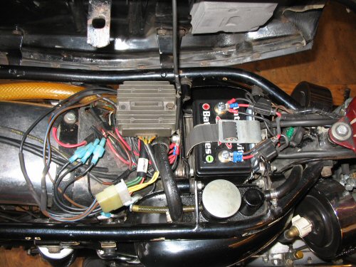

![]() Depuis 2018 Rectifier/Regulator Shindengen FH020AA MOSFET |

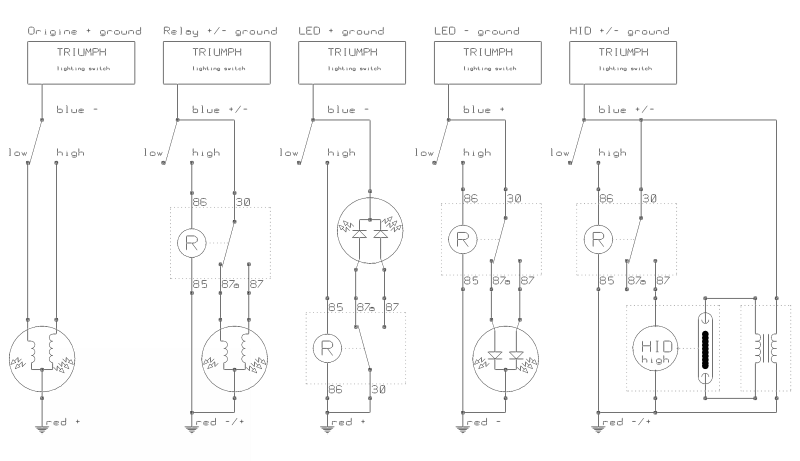

| HID Xenon 35/35 W + Items (1, 2, 3, 4, 5, 7) |
Philips Lumileds 20 Watts + Rigid Industries LED Lighting - SR-Q - Flood - Single 20 Watts
| Camera Viosport POV.1 70° 720x480 + Items (1, 2, 3, 4, 5) |
| Camera Viosport POV.HD 142° 1920x1080 + Items (1, 2, 3, 4, 5) |
![]() 20140819 HID Xenon H4D 35/35 watts High mode + Rigid LED 20 watts + Item 7 |
![]() 20140819 HID Xenon H4D 35/35 watts Low mode + Item 7 |
20150806 Philips Lumiled 20 watts High mode + Rigid LED 20 watts + Item 7 |
20150806 Philips Lumiled 20 watts Low mode + Item 7 |
