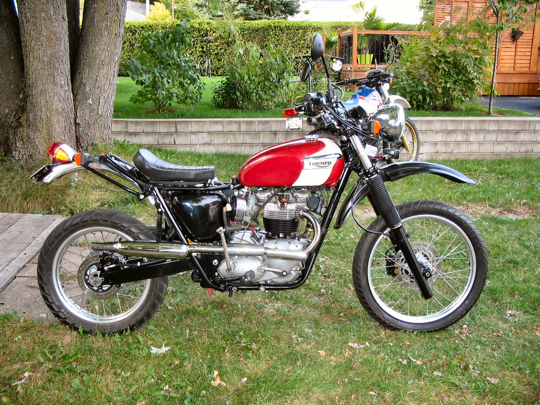

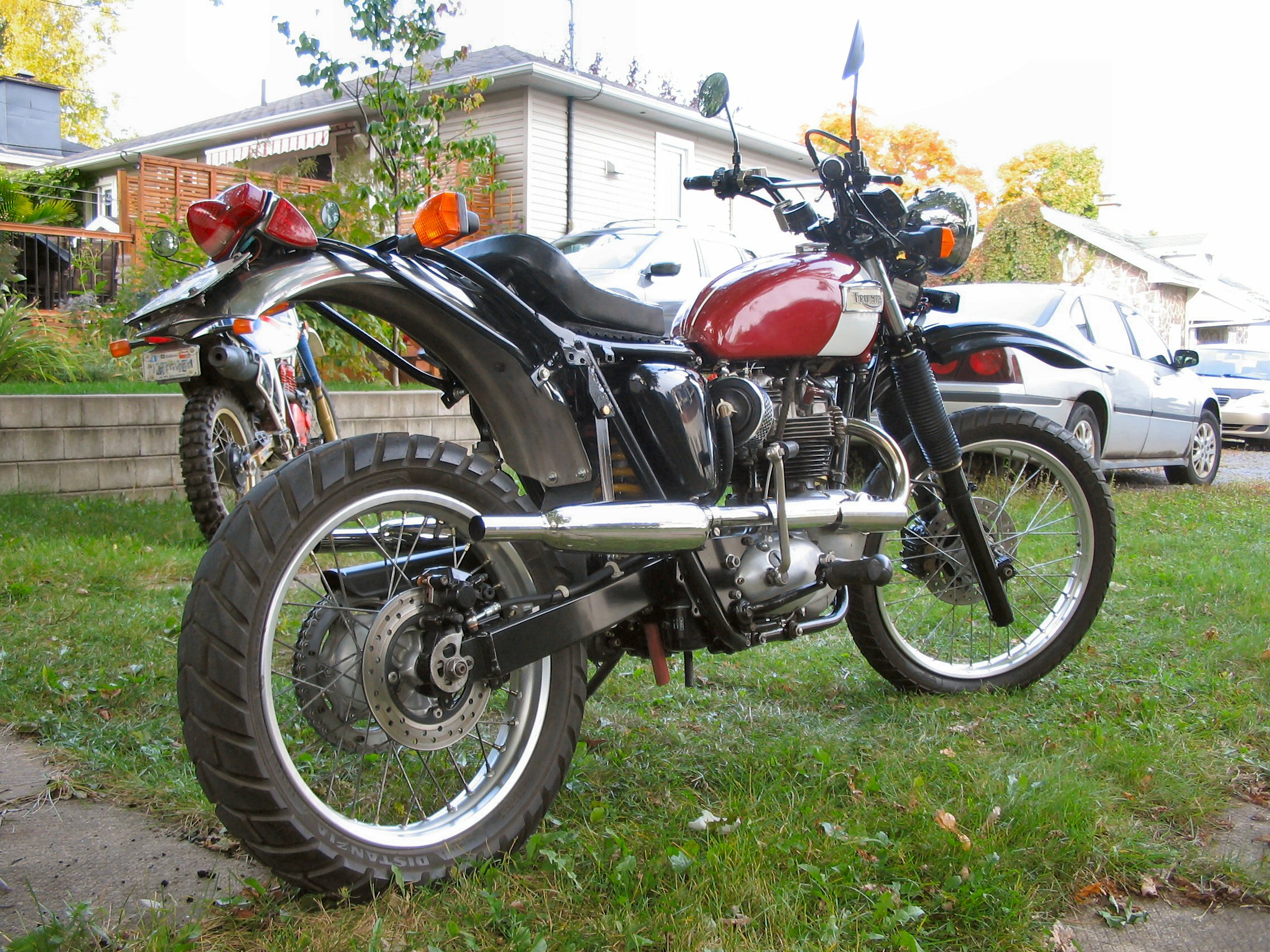

- Front frame T120R 1967
- Rear frame TR6C 1969
- Skid plate TR6C 1969
- Swingram Honda XR650L 2004
- Complete front fork Honda XR650L 2004
- Front wheel Honda XR650L 2004
- Front brake Honda XR650L 2004
- Top yoke & stem Honda XR650L 2004
- Rear mono-shock Honda XR650L 2004
- Complete rear wheel Honda XR650L 2004
- Front fender Honda XR650L 2004
- Race Tech Triple-Rate Fork Spring Kit - FRSP 3750K
- Race Tech Gold Valve Fork Kit Type 1 - FMGV 2040
- Rear fender TR6C 1969
- Exaust pipe T120C 1966
- Muffler TR6C 1967
- Complete footrest TR6C 1969
- Seat Flat-Track Universal
- Petrol tank T120R 1970
- Oil tank T120R 1967
- Norton oil filter kit
- Crankcase T120R 1967
- Gear box TR6C 1969
- Clutch complete T100R 1972, with 7 Plate Clutch Conversion Aerco UK Made PN# TBS-0213; Barnett heavy-duty springs
- SRM 3 spring models Pressure plate kit
- Magura Hydraulic Clutch conversion Rask Cycle HYC2
- Crankshaft T120R 1972
- Rocker box T120R 1967
- Cylinder head T120R 1972
- Morgo Unit Rotary Oil Pump
- PS215 Routt 750 big bore kit& Stainless O-Ring
- Carrillo conn-rods
- Pazon TwinPlug/cylinder PD2TP
- Headlamp shell T120R 1968
- Light unit Yamaha Road Star
- Philips Lumileds 20W
- Rigid Industries LED Lighting - SR-Q - Flood - Single 20W
- Tail lamp T120R 1969 withLED conversion for L679 & L917, 12V
- Lucas High-Output 3-Phase Alternator 180 watts RM24 47244
- Rectifier/Regulator Shindengen FH020AA MOSFET, 1D7-81960-00-00, 2018 Yamaha Super Tenere XTZ12JL
- Light/Flasher/Run/Off switch Honda XR650L 2004
- Flasher set Honda XR650L 2004
- Speedometer Honda XR650L 2004
- Koso Digital TachometerBA4800R0
- Koso Mini 3 Amp & Volt MeterBA003190
- VEI Systems Dual Oil Pressure & Temperature D1-OPP-OTC-M
- Innovate MTX-L Plus Digital WideBand Air/Fuel Ratio Gauge
- Antigravity Batteries AG1201
- Air Cleaner Assembly
- K&N TB-0300 Replacement Air Filter
- RK 530XSOZ1 X-Ring Chain 122 links
- Fiamm horn
- Enduro handlebar
- Hand guard, Probend CRM, Limited Edition Cycra OPS
- Powell Peralta Bolt on Chain Tensioner
- Front tire:
  Metzeler MCE Karoo-2 110/80-19
  Avon Distanzia 90/90-21
  Continental TKC80 90/90-21
  Pirelli Scorpion Rally 90/90-21 54R MST
  Metzeler MC360 Mid Hard Front Tire 90/90-21 54M MST
  Michelin Desert 90/90-21 54R
- Rear tire:
  Metzeler MCE Karoo-2 140/80-18
  Pirelli MT21 RallyCross 120/90-18
  Continental TKC80 120/90-18
  Avon Distanzia 120/90-18
  Pirelli Scorpion Rally 120/100-18 68R MST
  Pirelli Scorpion XC Mid-Hard 120/100-18 68M
  Metzeler MC360 Mid-Hard Rear Tire 120/100-18 68M MST
- Système d'aération du moteur modifié pour le transfert et l'ajustement du niveau automatique de l'huile dans le boitier d'embrayage, ainsi que diverses modifications du boitier moteur pour éviter la tite goutte d'huile emmerdante sur le pavé quand on stationne.
- Ainsi qu'une multitude de modification apportée sur toute la moto
